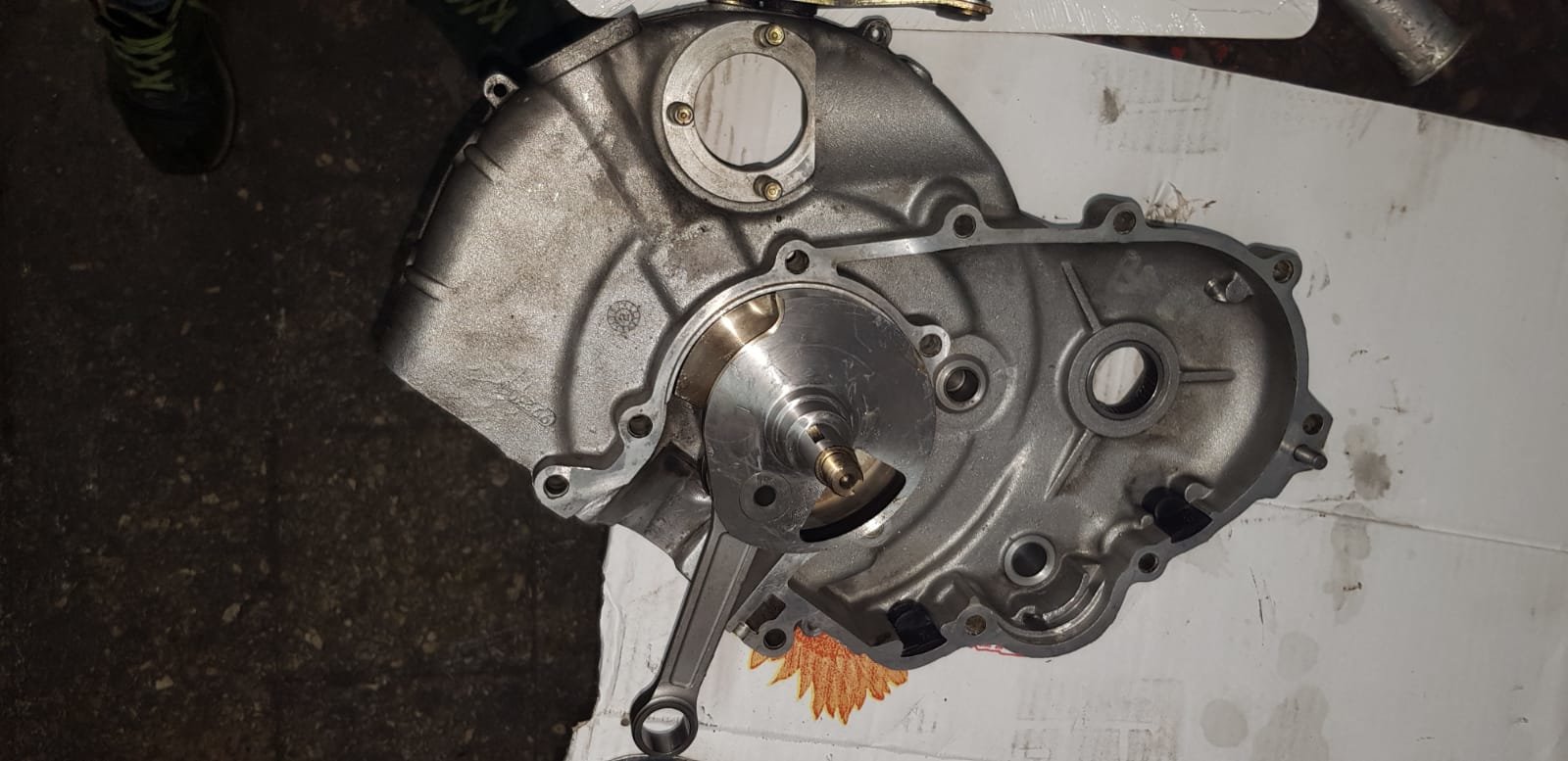

Visite recenti
Pedrozzo's Achievements
  • Week One Done
